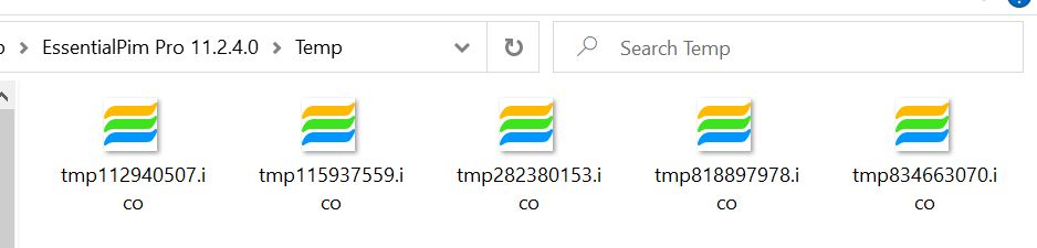

I am using the portable version of the program. I don't have an EssentialPIM icon file in the (portable) program folder, but I do have an EssentialPIM icon file in the temp subfolder of the program folder with a random name.
So I finally think I understand what have changed from earlier versions here.
1. Let's say you are starting EssentialPIM.exe for the first time
2. An EssentialPIM icon file is created under <path to your essentialpim folder>\temp\ with a random name
3. A shortcut is created under C:\Users\Username\AppData\Roaming\Microsoft\Windows\Start Menu\Programs\. The icon in the taskbar works.
4. If you close the program file and restart it, the shortcut in the C:\Users\Username\AppData\Roaming\Microsoft\Windows\Start Menu\Programs\ will still point to the icon file with the last random name, which doesn't exist any longer, because that file is deleted as a part of the new program execution, and you'll find the same icon file with a new random file name in the temp folder. Now the taskbar icon is NOT working. The reason for this is that the icon pointer in the shortcut is pointing to the old random named icon file.
5. If you delete the shortcut in C:\Users\Username\AppData\Roaming\Microsoft\Windows\Start Menu\Programs\ before you start the program again, a new shortcut is created which also uses the same icon (new) icon file created with a new random name.
If I remember correctly you could earlier see a lot of essentialpim icon files in that temp folder if you had run the executable several times. Know you have some sort of "cleanup" at each program execution, but the icon path in the shortcut under C:\Users\Username\AppData\Roaming\Microsoft\Windows\Start Menu\Programs\ is not updated accordingly.
@Admin:
This seems like a code bug. Just a suggestion from my side; Why can't you just call this icon file EssentialPIM.ico without any random filename like tmp951763298.ico? Then it would actually work as it should on every execution.
This is reproducable by starting the exe file directly from the program folder, or by starting the program from the start menu, or by starting the program shortcut in C:\Users\Username\AppData\Roaming\Microsoft\Windows\Start Menu\Programs\.
EssentialPIM 11.2.4 created one new icon file pr execution, and the last used icon file would always be available. From version 11.2.5 and forward, every icon file in program folder\temp is first deleted on a new execution, and a new iconfile with a new random name is created. The shortcut though, still points to the icon file from the previous execution. So either the icon file should have a static name, or you need to also delete and recreate the shortcut under C:\Users\Username\AppData\Roaming\Microsoft\Windows\Start Menu\Programs\.
Cheers

You could also copy one of the temp icon files from the temp folder to the program folder, rename it to for example epim.ico, and then change the shortcut to use that icon file. Then the taskbar icon will work on every execution. If you try to rename the icon file in the temp folder, it will be deleted as part of the cleanup on every execution.
This should be pretty easy to fix if you look in the code, but it will confuse users that doesn't know how to fix it. The icon file itself could be a static named file in the program folder. It is no reason to recreate it every time the program is started?
