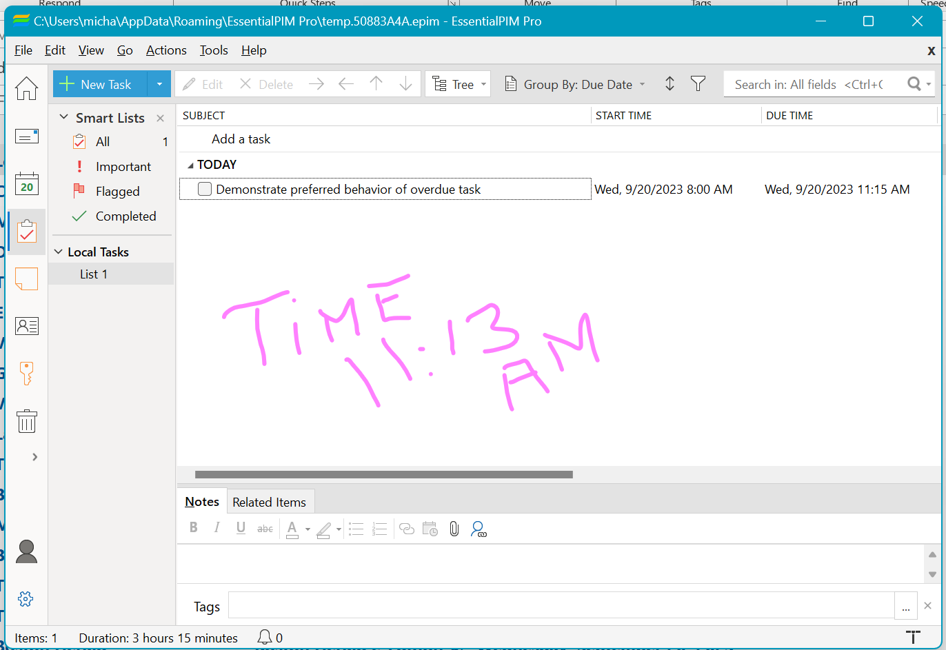

For the demonstration, let's start with a single task displayed in task view set to group tasks by Due Date. Here is a screenshot:
The task is named "Demonstrate preferred behavior of overdue task," the START TIME is "Wed. 9/20/2023 8:00 AM" and the DUE TIME is "Wed. 9/20/2023 11:15 AM." THe current time is 11:13 a.m., two minutes before the completion deadline.

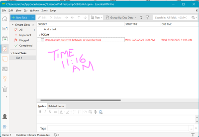

Three minutes later, at 11:16 a.m., the task is still not completed and the completion deadline has been missed:
The only change shown in task view is that the task's color is red instead of black.

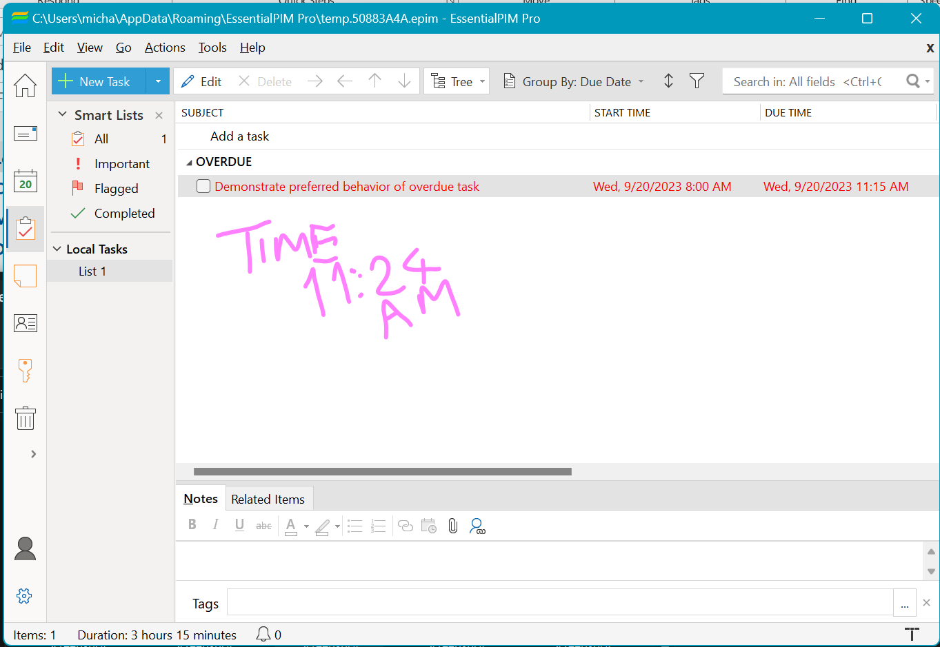

and then at 11:24 a.m. we switch back to task view to find that another change has occurred:
The task has now moved from the TODAY group to the OVERDUE group.

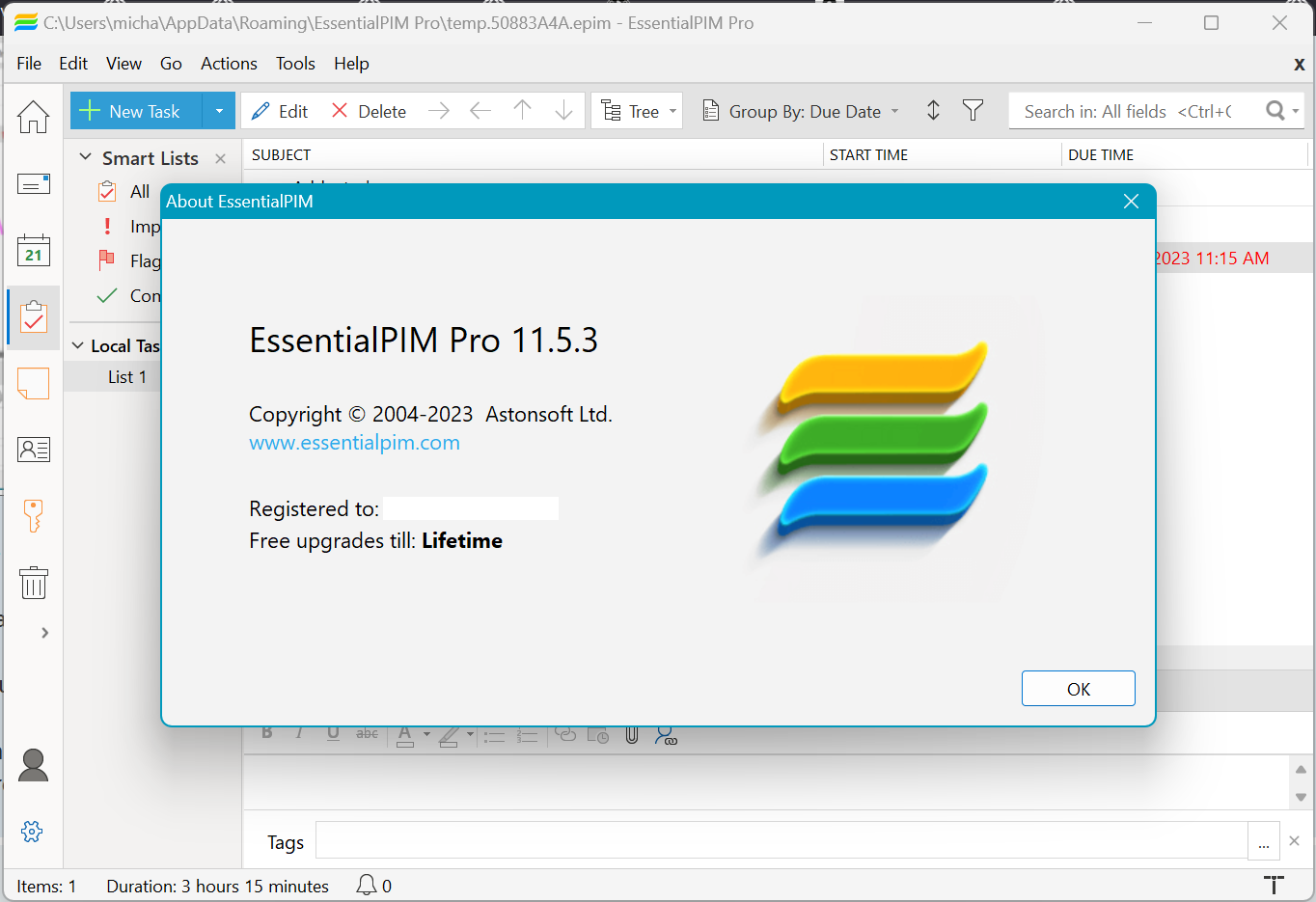

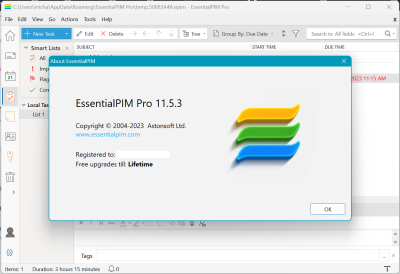

The version of EssentialPIM Pro used in this demonstration is now displayed as 11.5.3:
The accuracy of my description of the behavior of tasks as their deadline passes in former versions of EssentialPIM Pro has been demonstrated.
