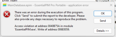

Not sure if this helps, but I got the attached error message trying to send a Reply.

Re: Can not reply to emails
What is your Windows OS version number? Are you now running the build I posted a link to above?

- Here is a copy of the text from the error message I can not send you:
Exception log with detailed tech info. Generated on 6/21/2024 10:07 AM.
Application title: MainDatabase.epim - EssentialPIM Pro Portable
Application file: R:\Program Files\EssentialPIMProPort\EssentialPIM.exe
Application: EssentialPIM Pro Portable 12.0.1 6/15/2024
Exception class: EAccessViolation
Exception message: Access violation at address 0040B75A in module 'EssentialPIM.exe'. Write of address 00610018.
Exception address: 0040B75A
Main thread ID = 12312
Exception thread ID = 12312

- Posts: 17164
You are referring to the latest error log you included in your last message, right? Does this issue always occur when you click on the reply button (the one from the toolbar)?
