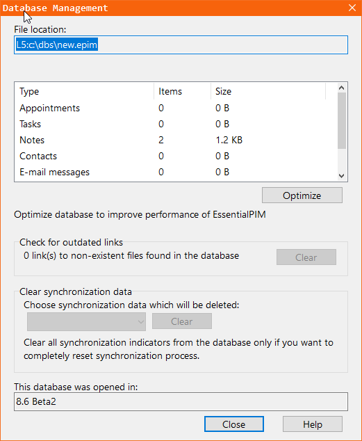

Re: Bug - DATA LOSS RISK when using stickies well connect to a host.
Another video using two entirely different systems. [including a just installed today EPIM business bundled firebird server.] and a screenshot showing that the database is fresh.
