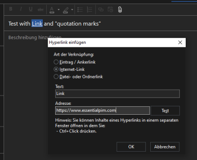

Links
Another issue I found is that urls of links are not exported. In the screenshot you can see "Link" has a hyperlink defined. In the exported ics it is just text without url (see below). It would be good to keep the information somehow, for example using braces or brackets: Link [http://essentialpim.com]. There is also the ATTACH field in the ics standard, so maybe use [1] [2] ... to reference the attached links?!
Otherwise you would need to go through all the events and change the links to contain the url als text.

Links

Re: ics export issues (links, quotation marks, alert datetime)
Quotation marks - Thank you for your feedback, we will investigate this.
Links - There are no links in the iCalendar specification and attempting to fit them into the ATTACH field would not be the best option.
Alarm section: - The behavior of alarms largely depends on the app. For example, if an event is moved to a different time in EPIM, the reminder remains relative. However, we will explore the possibility of including relative alarms in iCal exports.
